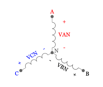

For a balanced, positive, ABC sequence wye system we will have the following phase voltage vectors when the A phase to neutral voltage is at zero degrees:
Where the phasor diagram for the phase voltages looks like this:

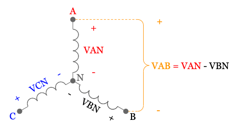

Now to get to line voltage, we have to measure the voltage across two lines, skipping the neutral. If we measured the A line voltage, which is the same as the voltage across A line and B line, it would look something like this:
To get to the correct formula for the A line voltage, we have to add the voltages from A to neutral, and from neutral to B. Play close attention to the polarity in the diagram and notice how we are actually subtracting the two phase voltages:
Next lets start the long process of converting both to rectangular (since we can’t add in polar), then subtract the two vectors, and lastly convert to polar and see what we end up with for our A line voltage

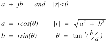

First a quick trig and geometry refresher on how to convert between polar and rectangular:

That is the value of the line voltage in rectangular form, let’s covert to polar form and see what happens:
This means that the Line to Line voltage of a balanced system, will always be equal to:
The difference of two phase voltages (because of polarity when crossing the neutral)
Which equals the square root three times the phase voltage magnitude
and will lead the phase voltage by an angle of 30 degrees
The phasor diagram looks like this:

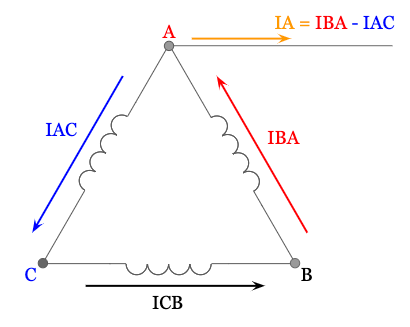

The same math works out for delta systems since for a balanced system the phase currents are also equal in magnitude and are spaced 120 degrees apart.
Try doing the math for a delta system on your own
By adding two phase currents to get one line current:
And see if you arrive at:

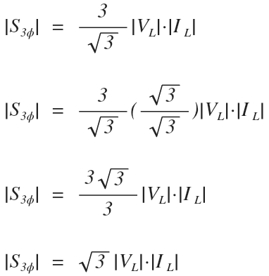

Next let’s match the original three phase formula that uses line values, by substituting line values for the phase values.
This works either way for a wye or delta system:
If it’s a wye system, phase current equals line current, but we know the phase voltage is √3 times smaller than line voltage:
If it’s a delta system, phase voltage equals line voltage, but we know the phase current is √3 times smaller than line current:
Lets see what happens when we substitute our line values into the formula, and manipulate it to get the square root three out of the bottom position of a fraction:
And Voila.
