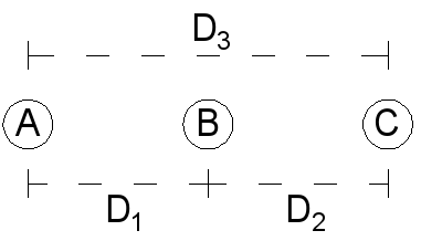

Let’s look at the formula for line capacitance per unit length of a three phase transmission line:
Where GMD, is the geometric mean distance between phases, or:
And D1, D2, and D3 are the distances between three separate conductors:
We know that as D1, D2 and D3 increase, the value of GMD will increase since:
And as the value of GMD increases, the value of capacitance will decrease since GMD is a divisor of the capacitance formula:
Therefore, we know, that increasing conductor spacing will decrease line capacitance and decreasing conductor spacing will increase line capacitance.
The correct answer is False.
Or, The capacitance of a transmission line will not decreases as the spacing of phase conductors decreases.
If you are having a hard time following these steps, or you would like to try a more practical way to solve this question, try solving for capacitance using D1 = D2 = D3 = 1, and comparing it to the capacitance if D1 = D2 = D3 = 100.
You will end up with a smaller value for capacitance with the much larger conductor spacing distance.
